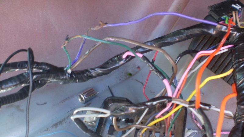

ok well my looms been cooked Evil or Very Mad and i need to no what amps the burnt wires are im thinking the dark green would be 10amp the purple ones 15amp and the brown ones 25amp but thats just a guess so does anyone know?
and in this photo im thinking the yellow wire (shown in photo) that plugs into the same slot as the pink resistor wire would be 10amp ????scratch
and does anyone know where i could get some of that pink resistor wire
would supercheap have it or would i have to go to a auto electrician to get some?
cheers jake

Post by highwaymenace on 22/3/2009, 5:42 am
best to go to an autoelec, then you know you have the right stuff.

You can get an ignition resistor (Supercheap, Repco etc) to use on the coil.
Where abouts did the pink wire start to melt (not fuse box side)?

well ummm from what i can work out it comes from the firewall connector and go's straight to a plug above the steering column it doesnt got thru fuse box?????

On the engine side of the firewall connector...... Where does it go to?

Just trying to think where the pink wire would go to in the engine bay on a pre-pollution motor.

does any one know how to put a ballast resistor in can i use that insted of the resistor wire ??????????? if so where how cos iv been told resistor wires to hard to find and im better off putting a inline resistor in ?

Post by Guest on 23/3/2009, 12:42 pm
pano wrote:does any one know how to put a ballast resistor in can i use that insted of the resistor wire ??????????? if so where how cos iv been told resistor wires to hard to find and im better off putting a inline resistor in ?
cheers jake
Can't find my wiring book for your HJ yet. Sad
Yes you can put a ballast resistor in a supply wire from the ignition switch.
You could put it on the side of the coil or hide it inside if you wish.As long as it can air to cool the resistor down.

so one more dumb one for ya agro what do i do with the resistor wire if i put a ballast resistor in just take it out and put a ballast resistor in ignition power feed ?????

Pink wire on a HZ goes to the idle solenoid on the carby, a solenoid for the vacuum control to dissy (Near the carby), Kick down switch (Auto & on the accelerator pedal inside), reverse light switch, guages.
