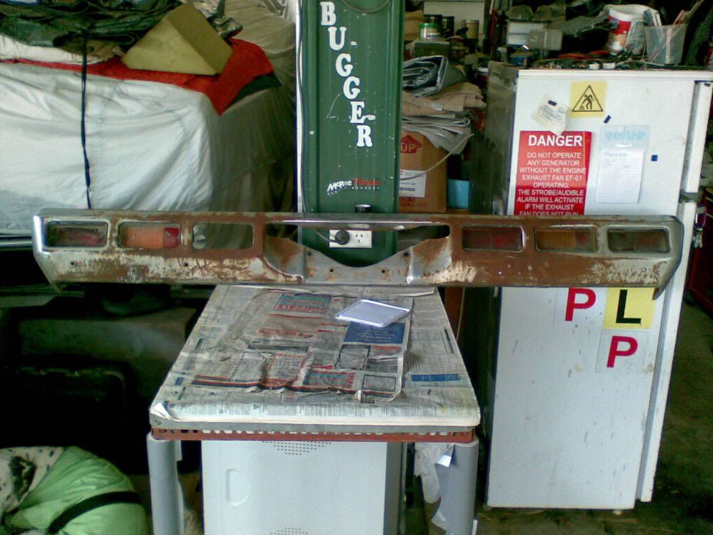

Post by Rusty62TransAm on 15/9/2009, 5:40 am
Picked up this Suttle Custom Rear Bar. A local Panel Beater still does them - a very good job. You'll still see the odd one around Albury.
This one yet to be cleaned up and powder coated or chromed. Cool affraid
Contemplating filling in the Tail lights on my Wagon and fitting this Bar.
regards
Rusty. Twisted Evil
Re: van rear bumper
Post by Pez on 22/9/2009, 8:22 am
I like the 6 light HQ bumper, and have thought about modifying one. Do you have the details of the panel beater who does them? Any idea of price?

Post by Rusty62TransAm on 22/9/2009, 8:45 am
Pez wrote:I like the 6 light HQ bumper, and have thought about modifying one. Do you have the details of the panel beater who does them? Any idea of price?
Cheers
Gidday Pez Very Happy
Zane's Panels, 7 Reid Street, Wodonga Vic 3690; (02) 6056 2100
Tell Zane Russell from Complex refered you.
As for price, Zane will be able to tell you.
The finish was so good people often rechromed them.
