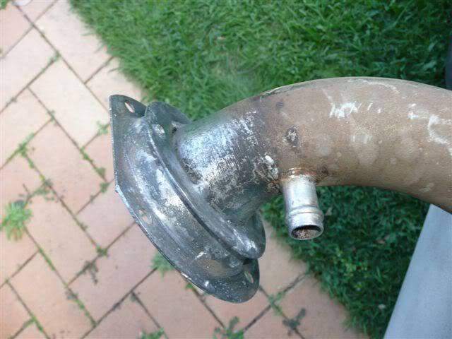

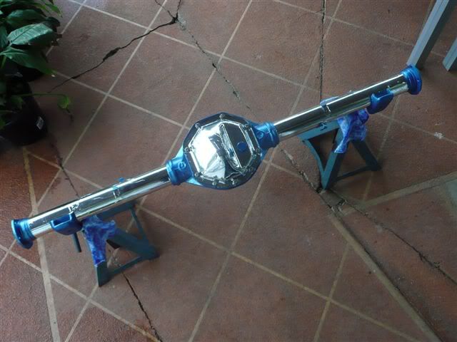

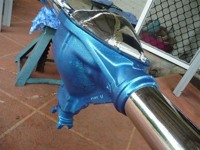

Well with the Van always intended to be jacked up, it was inevitable that the diff was going to be on show so a plan was hatched to undertake the most daring chrome vinyling job in my decade long association with this material. I originally was just going to paint the housing and get a cover chromed or polish an XF alloy one, but they all seemed like a lot of work or a lot of expense. To that end, I decided to take a leaf out of Brian Plankmann's book (remember his column from early issues of Street Machine?) and got stuck into doing a hell of a lot for not a lot of bucks. It all started with a healthy clean up to lose 30 years of road grime and strip of the diff tubes to bare metal. It was then primed and given a few good coats of eighties-spec Cyan Blue metallic. Next up was the worlds most tight-assed metalflake job to the exposed sections which involved buying a $5 can of spray glitter from the craft section at Bunnings (I'm serious), then the whole housing was given a good coat of gloss clear.
I then wrapped the tubes and diff cover plate in chrome vinyl sticker and the results speak for themselves. Yes, up close the chrome finish looks a touch peely due to the surface of the vinyl, but it passes the 3 metre test and you can't tell me it won't look the goods just prior to melting the retinas of unsuspecting motorists as I womble on past. All up cost? Just over $20 which included the stainless steel bolts... Oh by the way, its now got an LSD and 3.45 gears too!

dam great idea about the vinyl wrap on the diff. looks so real and its easy cleaned aswell, also easy fixed if it gets stone chips. keep up the great work Simo.. loving it.

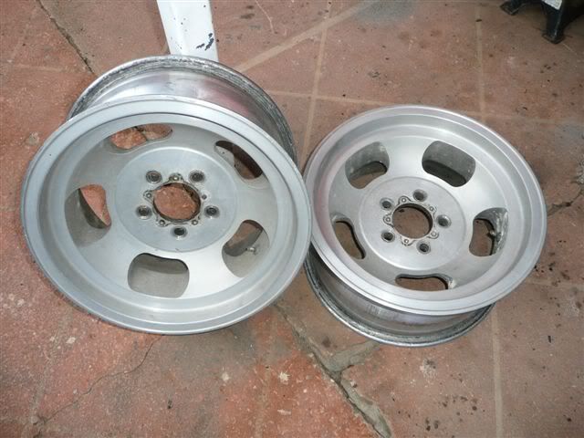

And surprise surprise, I've changed my front wheels again! A Mopar mate in Melbourne is the 15" jellybean rim guru and was kind enough to box and send me a set of 4 US racing 15x7's that I picked up on eBag, which will not only fill out the Trans Am front better, but will also give me two bigger rims to stick under the back of the orange van. They're in really good nick and should polish up well:

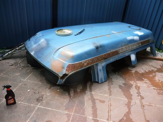

Ok, the distraction known as Mr Juicy is all but sorted so it was back into Disturbia this week. Thankfully the Brissy weather has calmed down a bit so it was back into the left sill. Last time I had finished most of the patching of the inner sill, so I spent a few hours this week sealing it all up and welding the replacement outer skin on. Now this is the first time I've tackled such a large patch panel and in retrospect would have done a couple of things differently now that I've seen how it looks once the outer skin is removed (namely where I cut it along the top, I would have gone into the door jamb for part of it etc.).
But I'm happy with how it came up so its one more thing ticked off the list.

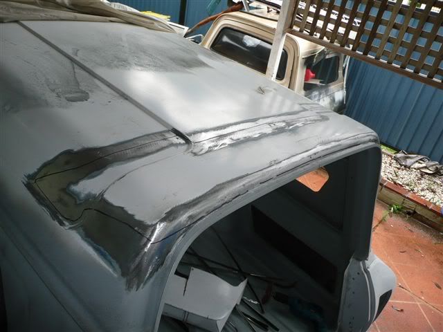

First up was a good coating of rust converter, a prime and then a solid coat of black killrust:
Then it was time to locate the skin and get it welded in. It was a slow process of tacking and cooling the top edge and sides but I tried to avoid any warpage so the patience was difficult but a necessity! The Chrysler factory spot welded the bottom seam in about 15 spots but I decided to hedge my bets and do about 8746 welds instead:
All ground back and its come up amazingly well for me, a welding-impaired gasless Migger, so a quick skim of filler over the join and it'll be done:

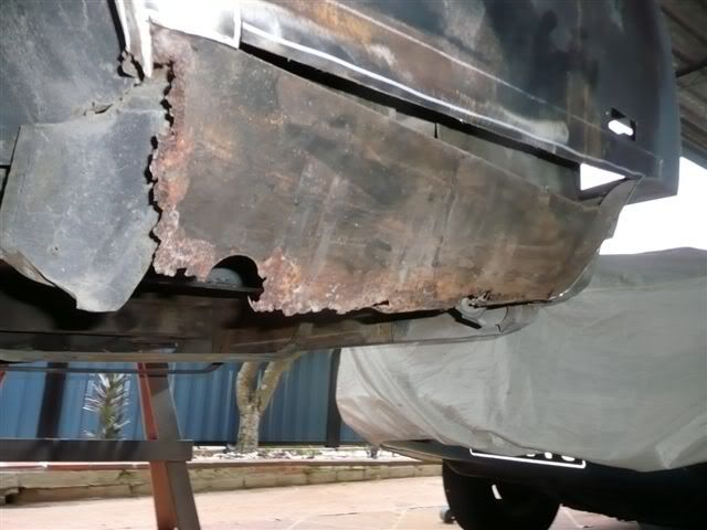

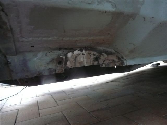

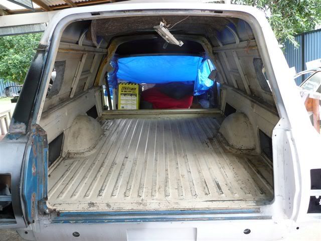

Next up was to start poking around the lower left rear 1/4, it was not only full of rust and bog but has a nice crease right along the factory pressing so unfortunately I had to go quite high with the patch panel:
But first I better tackle the rotten inner panel....

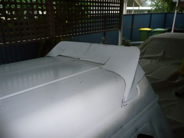

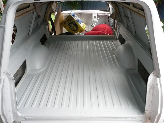

Anyhoo, while this was all happening, VE Azz got busy bare metalling the tailgate and I started repairing the rotten left rear inner 1/4 panel. Man he got through it fast, must have been the Rose Tattoo he had pumping through those earphones!
So I got busy making a patch panel on the err.. workbench... then checked it for fitment:
Then it was welding time which went nice and smooth and last Sunday I sealed up the inner panel, primed it, then doused it in Killrust. I also trimmed and final shaped the outer patch panel which was next on the cards.

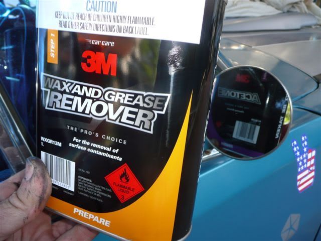

Hey, here's a trap for young (and old) players, we picked up this spankers can of 3M wax and grease remover from Super Shite, but have a look at what the back label says in the rear view mirror, that's right, its been incorrectly double stickered and unfortunately we learnt the hard way on Azza's just repaired bonnet that it was in fact Acetone and not the much more paint friendly W&G remover...

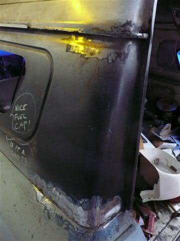

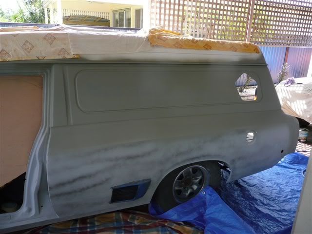

So, after getting the left lower inner rear quarter piece sorted last Sunday, it was time to zip the outer patch piece on. I bought this patch from Hemi Performace about a week after I bought the Van so its been sitting around for about 5 years... It was a pretty neat fit actually but needed some slight massaging to line up the wheelarch pressing. The biggest pain with this left rear 1/4 is that its had a scrape at some stage in its life, right along the pressing, and copped a very ordinary bog job which will be dug out and redone. So I got it all trimmed and tested then clamped it in for final tacking:
With the tacking done I test fitted the bumperette just to make sure the gaps were all cool then the following afternoon welded the whole lot into place:

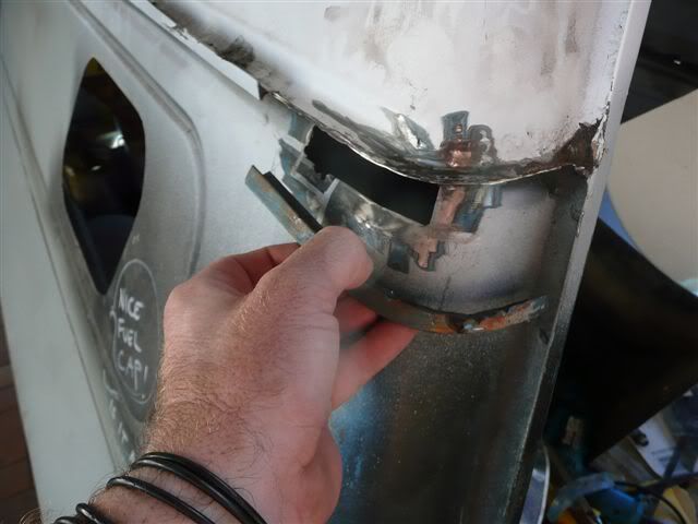

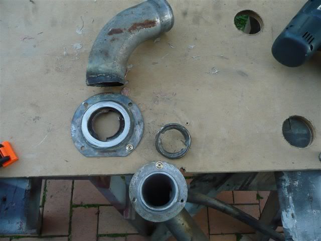

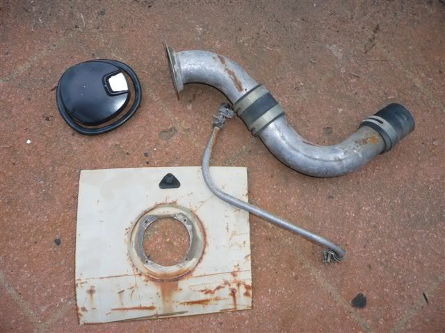

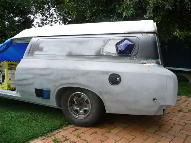

Then it was time for something 'fun' and I decided to slot in the Falcon fuel filler recess to mount the GS flip cap. As you know these caps were all the rage on Vans (and utes/sedans/wagons really) of all makes back in the day so should keep this pretty era correct. As much as I love the R/T style flip caps, I just think they stick out too far on Vans/utes IMHO (no offence to the many people who run them on their own commercials!) so decided to take the harder road.
So the donor panel from an XB ute was trimmed up after eventually deciding on a size and shape, and the corresponding factory filler recess carefully cut from the rear 1/4 and put away for safe keeping in case I ever change my mind back! I was originally going to line the pressings up centre to centre (of the filler hole) but the safest bet was to align the top of the round larger Ford pressing with the top of where the factory round Valiant pressing originally was; this gives plenty of room to mount the Ford finishing ring and doesn't have it looking too 'Harry Highpants' up the rear 1/4 either. The XB piece was carefully tacked and adjusted, then the cap was mocked up to make sure it was square with the CL body pressings.
You know its funny, I love the GS caps but have despised the factory stock Falcon caps since I was a kid - I could never get over why the factory put in these massive fuel caps and they look terrible, and fark me dead they look even more ridiculous if there's a big chrome fuel spill tray mounted under there as well! So in saying that, it seems ironic that I'd cut up the quarter to fit the pressing that could mount both the awesome and atrocious fuel caps. After having a nightmare last night that I broke the flip cap and all I could replace it with was a factory style XB chrome twist off cap and a spill tray, I've decided to buy a spare flip cap, just in case...
The whole 1/4's looking rough but I'm making progress:

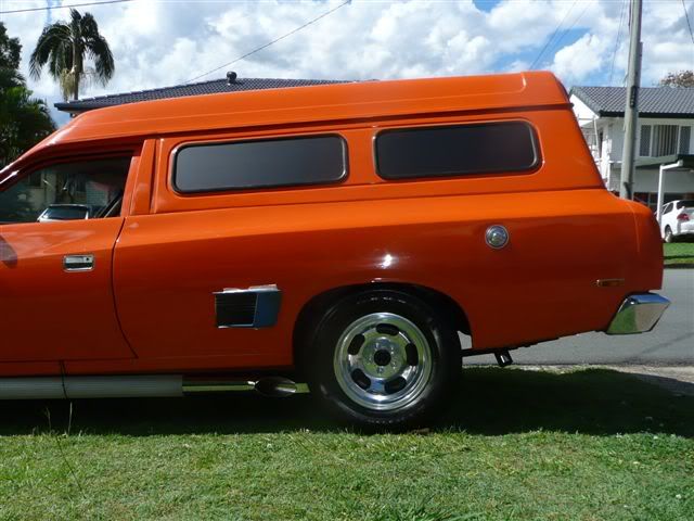

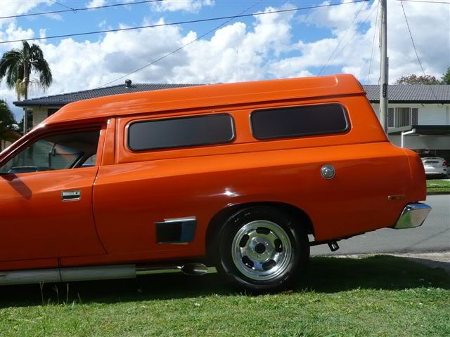

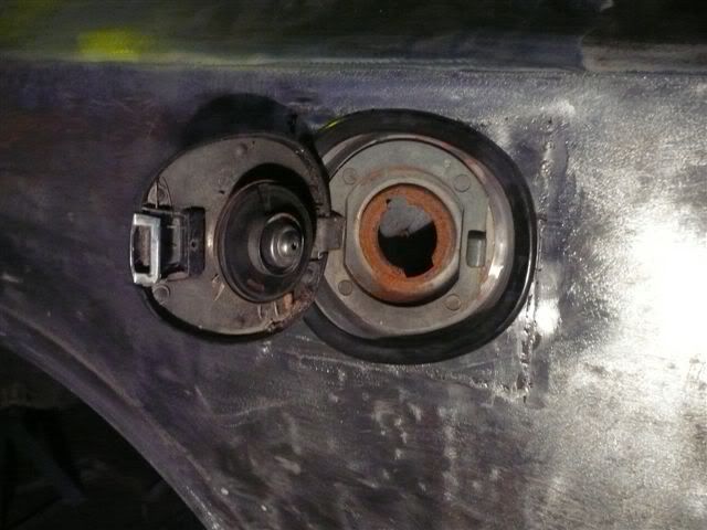

With the positioning all Kool and the Gang, the filler piece was fully welded and I plated the rear side marker hole at the same time, leaving a centre hole to line up the holesaw for the Dodge side marker lamp to match the right side - I did that one about 8 months ago!
The cap was refitted with the Falcon filler tube, I drilled some extra holes and mounted up the factory black Ford surrounding trim that tidies up the whole cap cap area. The plan is to paint the fuel cap body colour, leave the button chrome and buy a repro chrome surrounding ring to use instead of the black one here:
So there you go, just needs a final finish and body prep which will tick a few more jobs off the list!

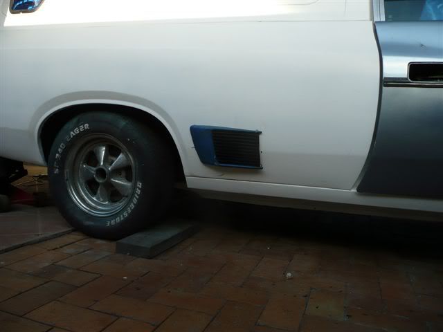

Have been able to dribble a few hours into the Van this week, got a bit sidetracked helping my Dad with his newly acquired VG Dodge Ute which should be a cool hauler for him soon.
I've basically just been plugging away on the lower left rear 1/4, finishing off the welded-in bits and the fuel filler conversion. It's had a decent scrape right along the wheelarch and left centre at some stage which seemed to include all of the factory pressings but I've managed to get it sorted with some patient tapping, filing and smoothing. The plan now is to skim coat the whole side American Hot Rod style and get it all in hi-fill by the end of the week.
By this arvo I'd had a gutfull (lung full?) of bodywork so decided to do the fuel filler mod to adapt the Falcon filler tube top plate to the smaller diameter Valiant filler tube. It was going to be too much messing around to sleeve the two different pipes together so I decided to cut the Falcon top plate off from its standard tube and just trim the outer cap lip from the Valiant one just so the tube remained behind:
And geez its like it was meant to be, the larger Falcon cap plate fits beautifully over the diameter of the Valiant filler pipe and butts up nicely against the original Valiant pipe mounting ring. I'll get one of the guys at work who know there shite to braze/mig/solder the two together to seal it along their mating surfaces:
All I'll need to do is cut the steel filler pipe about half way along and add a new rubber hose joint to make assembly easy as the Falcon tube fits from the outside and the Valiant from the inside due to its length and shape. I could probably run the Falcon plate on the inside but I'd rather keep it as nature intended to make sure the cap seals properly.

Had a good week of progress starting with the filler tube which a mate at work silver soldered for me. I just need to slice the pipe at the halfway mark and add a second hose joiner to make it a piece of cake to fit. I can't believe how well the Falcon and Valiant bits worked out; they went together like peas and carrots, Forrest and Jenny, or Vans and Drive-Ins.
Then it was back to the bodywork, got the left rear lower 1/4 all etched and hi-filled:
Its been great having Mr Juicy to use a mock-up tool for bits and pieces where I can actually stand back and have a good look at stuff and do proper measurements due to the wheels and heights eventually being pretty much the same. To that end I mocked up the sidepipes to make sure I got the 100mm ground clearance (easy done, with them being more like 150mm) and finally sorted out a position for the Gus flutes for the rear 1/4's. These are fibreglass copies of the cast XBGT Coupe versions and were a popular accessory for Vans back in the day. On Falcon coupes and when I've seen them on utes/vans, they always seem to be mounted really high in line with the top of the wheelarch whereas on a Holden they'd always be fitted halfway up the arch which I always preferred. problem with Valiants is that there's a body pressing right in that spot and was always worried it could look a bit odd. So a mockup was done and it didn't look as out of place as I thought so am going at the midway point.
Here's it mounted Falcon coupe style:
and the lower preferred height which gets the big double tick:
And the most important thing is to make sure the scoops didn't hang out too far from the sides so it wasn't going to look like a Van version of 'Muffin pants', but the mid arch point was no probs. See back in the day you could just flare the ass out of your guards which made them blend in nice, but I can't get away with that these days and the 15x8.5's and 255's put me at maximum track and wheel and tyre size for a CL:
The scoops and pipes will look the goods I think! The pipes have now been split so the front elbows and main tubes can be HPC coated to bling them up and match the truck exhaust tips:
I decided to whack a spare diff and main springs under it so I could finally move it for the first time in eons:
Fark she's lower than I expected though; the sills will be a bit scary to paint but at least the roof will be easier!

Well I managed a few hours on the Van over the weekend after being away with work for the week. First up was to attach the GuS side scoops by 'glassing some studs onto the rear of them. These are fibreglass replicas of the real XB scoops which are normally diecast or something. That is lucky because they needed some shaping to get them to fit the desired position on the side panels... yep, I would have to like them low down which ended up right on top of a factory pressing. It was pretty much put them here or leave them off altogether as they looked crap fitted up high. They'll be painted body colour with the blackouts which should make them a bit more subtle. I thought I was going nuts trying to get the positioning dead equal but it turns out that the two scoops are slightly different shapes so its lucky you can't look at both sides at once!:

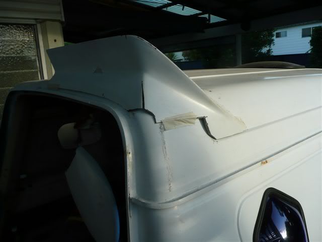

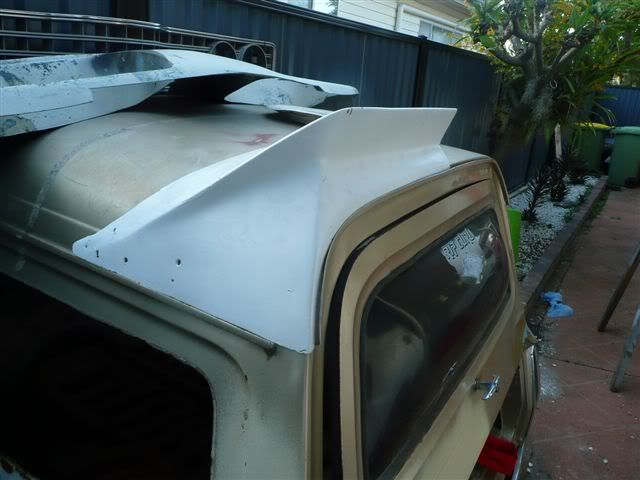

While I was in the mood for fibreglass bits I decided to start altering the roof spoiler that was originally designed for HD-WB Holden Vans. First up I had to cut it into two pieces and remove about 4" of its width to get it to fit the narrower Valiant roof. As you can see its a perfect fit when trialled on the HZ garden storage shed I have:
But on a Valiant it was not even close to fitting in a way like it was meant to be. The biggest problem is that Vals have the really pronounced and detailed roof pressing that runs for the full length and on both sides. The only roof spoilers I have ever seen on a Val is the airfoil John Goss XB Hardtop style design, only problem is is that I think they look crap so I had no choice but to make this style work! I do have one of the airfoils here but even on the car it looks wrong.
I figured the best way to make it work with the pressing design was to make the pressing a feature and have the spoiler contour to the factory shape. As you can see from the half that's been modified, I've had to remove heaps of material to make it sit how I'd like, I know it looks rough at the moment but please have a bit of faith in how I think it will look once its cleaned up and moulded into place!
I also started some repairs on hell corner and starting making donor bits off the spare turret in the backyard:
Lastly for this week was to pick up the front guards from the soda blasters who stripped off the 50 000 coats of paint. They're in bare metal now so I'll weld some holes up, scrub them with citric acid then sand, etch and hi-fill them.

So it was on to the rest of hell corner which mainly meant sorting the gutter rails. I cut away some donors and shaped them to suit. It's a pretty straight forward job now after the amount of the rails I've replaced on this bodyshell so it all went nice and smooth. Here's the cut with the donor ready to slip into place, showing how its a pretty straight forward process:
Then slip her into place with some magnets and weld away:

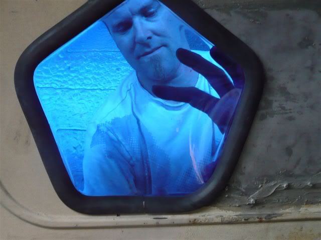

So then it was onto filling the left side window, I did the right one about 10 months ago I'd say, so this went a lot easier! First up was to cut the donor piece with enough meat left around the edge to recess a strip with the flange tool. The slightly weird shapes at the base came from fixing some rust at the same time where it had gone under the seal:
Then it was out with the Fusor metalbond panelbeaters gluey stuff and the piece was stuck in and clamped into place with pop rivets as its a bit hard otherwise to keep clamps onto it. Once that had had some time to cure, I traced on the window shape using the piece I cut from the right side which I'd managed not to chuck out or lose in the months since.
The window hole was jigsawed out and the tester pentastar bubble window slotted in to make sure it was all Kool and the Gang before I finished the prep and the paint:
The common thought is that I did a pentastar bubble window because of the whole Mopar thing, but there's another reason that is closer to my heart...
So the left rear is looking pretty busy with the scoop, cap, window and stuff, but once its all painted and detailed it should all blend in ok:
I can't really do much grinding or prep around that area until the fusor has had a good chance to set so I decided to clean out the back of the van totally and scrub it down to see what I've got to work with. The plan is to paint it all in plain white then deck it all out properly in blue crushed velvet once I've got it rego'd. I don't think I've ever seen it before like this! You can tell it had some gear in the back from its heyday as it has not one, not two, not even three, but six cigarette lighter points in the side panelling of the rear! That's a lot of TV's, fridges and tube lighting.
And on that note, I hope to have the upper left quarter prepped and hi-filled by the end of next weekend

The last of the sill repair (left front lower guard mount)
and the piece that started it all. This was the first small cut I made into the Van 15 months ago, a butchered hole from where someone had dodgied in the battery tray in its past - and was the last repair made to the Van!

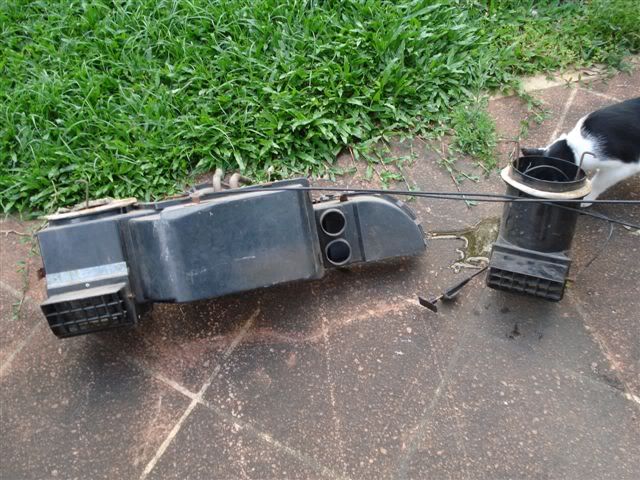

So I grabbed an extra drivers side vent and remove all of the unnecessary fusebox mounting bracketry, and fitted the longer heater vent cable and correct direction vent facia (the facias are handed to direct air towards the centre) from the larger heater box assembly. A good scrub in the motel shower got them all sorted and the matched heater delete pair is ready to bolt in when the time comes. Using two small boxes was the common method used by Chrysler to plug up the passenger plenum holes on pre 1/71 Valiants when they were ordered as non heater bare bones cars, and these late units are simply the early trap door type with the cable operated flap and vents screwed to the front.

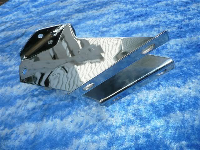

I also picked up a chrome offset V8 brake booster bracket which will bling up the engine bay a bit and go with the chrome detailing I have planned to keep it of the era; I managed to score it cheap due to some small blemishes with the chrome finish, but it'll be of no surprise to anyone that this was fixed in about 2 seconds with about 50c worth of chrome vinyl (who would've thought) and you can hardly notice that its on there. Geez that stuff is awesome and saves you a tonne of coin.

Well today's crappy Bris Vegas weather seemed like a great excuse to get a niggly job well on its way to being sorted. I was all set to do it yesterday but conveniently sidetracked myself by having a massive clean up - I'm getting to the stage now where I've got lots of refurbed goodies that I've been plugging away at all sorted to be put back on the Van, but was running out of clean places to store it all. I managed to make some room to try and keep it all in good nick.
The niggly job that I mentioned before again getting sidetracked is the roof spoiler for the back that I started to mess with a few weeks ago. I need to get this sorted asap as I can't paint the car until its all moulded in and prepped. It started out as a Holden HD-WB one piece job that I rescued from a mates HT pano many moons ago. The Holden roof is a totally different shape to the Val and to get it to mount in conjunction with the awkward Valiant Van roof pressings meant I could either try and bodgy it on as is, or make it seem like it was supposed to be there. I liked option 2 much better and has got as far as cutting the spoiler in two and starting to shape one side.
Well today I finished off the right half then made some mirror cuts to the left half to get it back to being nearly a usable item again. The plan was then to rejoin the two halves but I first needed to cut 6 inches out of its width (3 from each half) and reckon all up I've cut approx. 3" off its rear depth and 4" from its centre forward section. Here's the two halves butted together waiting for some action:
and when screwed together showed some promise (its upside down of course):
Firstly, I'm not a fibreglassing expert that's for sure, and my only experience with fibreglassing over the years has been what I've learnt asking questions and searching youtube, and cringing at really bad bodykits on VD Commodores (you know the ones, VD's have a tacky bit of every model Commodore from VB-VE blended into the one kit). So I figured that keeping the top profile edge straight was the safest way to keep the shape looking decent, and I then screwed some wood to each end of the centre cuts then glassed in a few layers of cloth to make it one piece again. I took the wood off and sat it back on the Van roof and as you can see by the pics I've had to do quite a few nicks and cuts to get it to sit reasonably flat against the body under its own weight so as to avoid too much 'pressure' of the glass trying to push back into its old shape whilst I'm trying to screw and mould it in later on.
So with it now at basically the right shape albeit very rough, the next step will be to screw it down onto a sandwiched layer of fibreglass, let that fully cure to hopefully avoid any cracking/lifting down the track, then mould it in from the top, and then finally finish over the joins by moulding it into the existing roof pressing shapes. I'll also drill a couple of breather holes in the roof skin directly under the spoiler as I'm super paranoid about it lifting/cracking once its on the road.

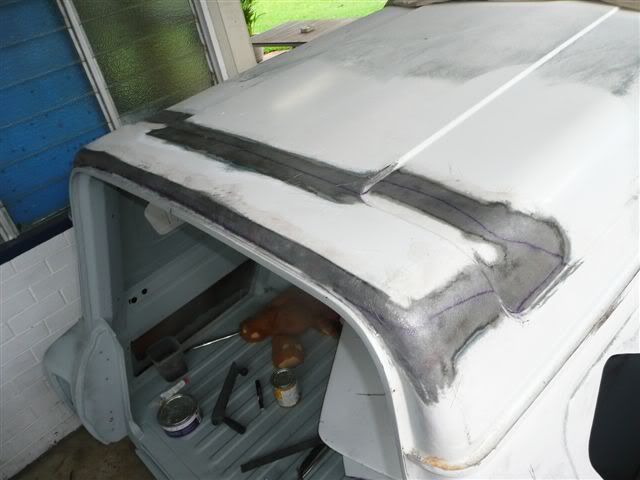

Oh mate this Christmas rain is sending me stir crazy! Nothing like having holidays and being able to do bugger all of what you have planned. So anyway I decided to keep plugging away at the roof spoiler. Its a bit of a long process but thought I'd post where I'm at anyway.
Now firstly, I've got to make it clear that moulding this thing in is a last resort, I would have much preferred to have bolted it down and sikaflexed the edging to compensate for body flex but the fact that this spoiler is totally not designed for this make of pano means that moulding it in is what I need to do to actually form part of the adaption from the Holden and make it fit like it's supposed to be there. Trying to bolt around the side pressings would look ugly and end up multi-seamed which is not the go, especially as the pressings are a good 8-10mm deep. I was originally thinking of just moulding the sides and bolting the centre to give it some flex, but in saying that I didn't want 'some' flex to actually induce cracking at the corners so it has to be all or nothing.
So anyhoo, I'm just going to keep plugging away, taking my time with my novice skills and will try to do the best possible job to make it last as long as possible! So after annoying a few experienced 'glassers and watching heaps of 'glassing youtube videos it was down to business:
First up I marked where the spoiler sits and 36 gritted the appropriate areas to give it some clean roughish metal to key into:
Then it was on with a decent layer of resin and chop sheet, flattened out with a thread roller to fark any air bubbles off then left to cure for 24 hours. As I mentioned earlier I'm going to sandwich the spoiler down to hopefully help it stay stuck down, and this is like an extra 'undercoat' surface to hopefully help promote bonding compared to normal bare metal.
Once that had cured I again 36 gritted the surface of this bedding layer, sat the spoiler back on and drilled the necessary holes to help mount it and hold it down until the second layer cures. The surfaces were then cleaned up, more resin and chop added and once that was all nice and gooey the spoiler was jammed back on and screwed down to help it set in place whilst the 'glass cures:
I was originally going to take the screws out once it had cured but don't think it'll hurt if I leave them in for good luck, they're stainless anyway so shouldn't cause any grief. So tomorrow I'll scuff this all back and start the top 'glass layers and then get onto 'glassing up the splits and stuff I had to cut in to help make it fit. So with a solid day between each step its taking a while but is worth it in the long run. Hopefully I can at least reverse out of my driveway for the first time and not have it crack!...
