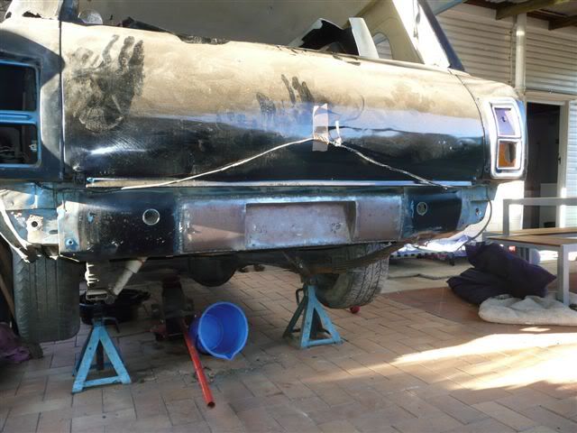

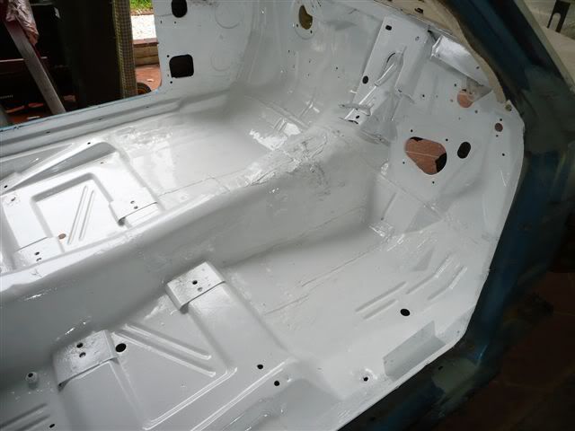

During the week I braved the dust & heat and got the rear pan welded into place and did the final finish on it today; it totally neatens up the half ass way they designed them back in the day and keeps the whole thing looking cleaner. The number plate lamps are LED ebay jobbies which are built in to the chrome heads of the number plate retaining bolts which saves a bit of stuffing around too.

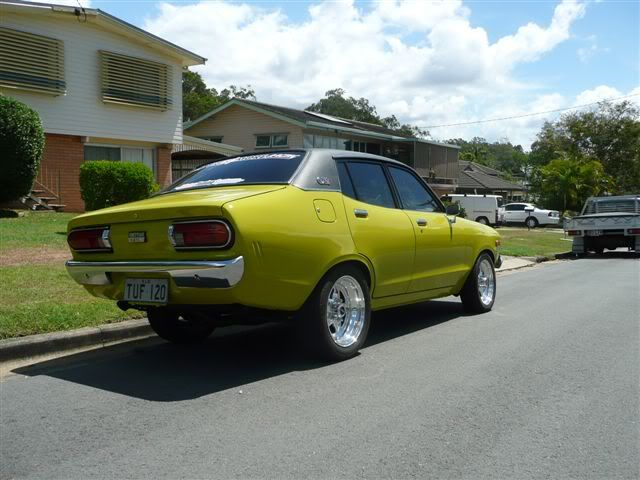

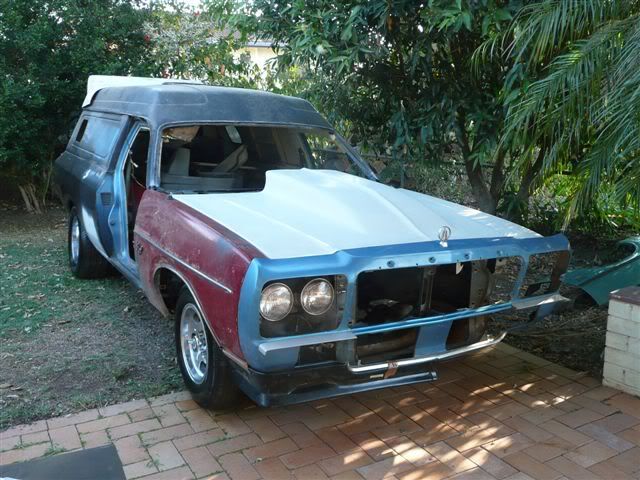

I hung on folks and found the rims I was really wanting, 15x8.5" Jelly's; I am totally stoked with how well they suit and fit the Van. It makes me want to paint the whole thing black and have big murals of Sophie Monk plastered all over it...
I also picked up a Camaro scooped CL bonnet off ebag which should suit it too, and saves me messing around with the projected 2 A9X scoops I had for it:

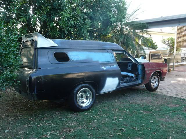

Had the old girl out on the backlawn today to make room during some yard reno's and couldn't help myself so took some more pics. I mocked up the new bonnet and gave the front 14x6" Sankey's a cut and buff to make them look more polished like the rear jobbies. I fitted up some old design Cragar S/S 3 bar spinner caps (have the knurling on the 3 bars) to the front and will leave the rear capless. Using S/S caps is probably a bit wrong on anything other than proper Cragar S/S rims, but I don't really care and think they look the part!

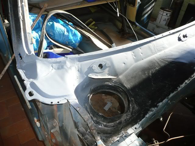

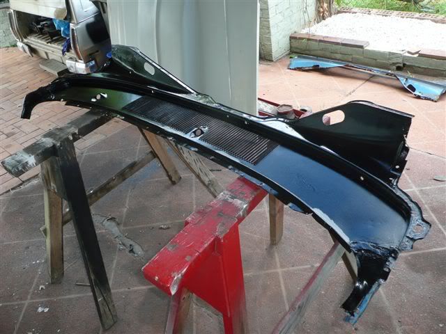

Things have been kicking along but pretty slowly due to other stuff keeping me busy; in between I managed to get the plenum top repaired and prepped, donor pieces are great but I think age is catching up with everything now so even the donor stuff needed work. So here's the plenum top all prepped and sealed underneath. The weirdo lava like bubbling at the ends is where I found the factory lead wiping with the mig... made for some action anyway.
The top in all its glory:
rust repairs and reforming of the rubber mounting lip:
Sealed and painted hopefully to never rust again..

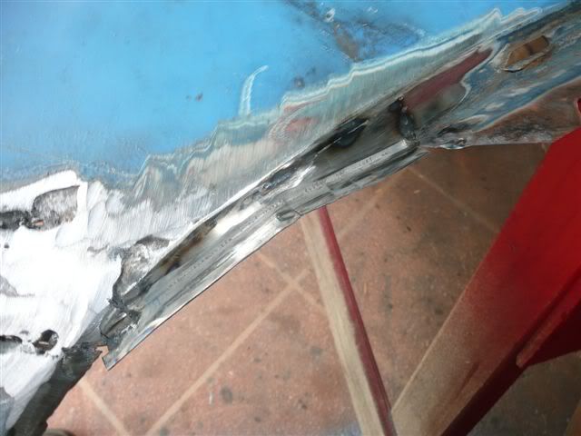

We held the the sequel to The Taking of Plenum 1-2-3 a couple of weeks ago and managed to get the top back on and the plenum repairs pretty much finished thank fark. A couple of hours saw it all zipped up and then it was time to have some steak sangers, a couple of beers/Cokes and a couple of boxes worth of Paddle Pops.
Here's Barry Jackpot trimming up the donor pillar bits:
sitting it on with the lower screen piece tacked on:
welded into place with the pillars cleaned up:

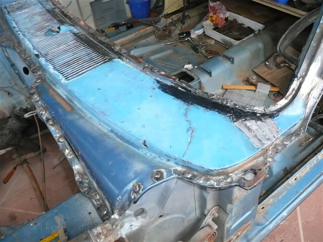

So since then I've reformed the lower dash frame mounts and screen seal seam using the dash, new screen rubber and thanks to some pics supplied by a few friends (I had nothing to go on, it was all rusted away!). Here it is before final finishing:
Once that was sorted the whole lot was primed and sealed in some acrylic and then I popped in the screen and dash frame to make sure it all fits ok; the last thing I want is to have the car 99.9% finished and find the screen doesn't fit... especially after its copped so much work.

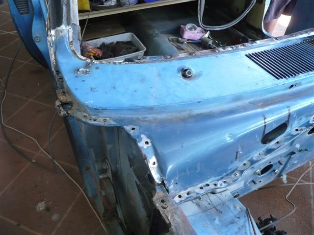

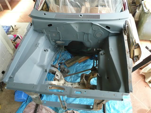

I think I've actually made it to a milestone! I'd pretty much bare-metalled the whole engine bay and welded up all the extra holes and the wiper motor hole over the last few weeks, and after finishing up the engine bay and new plenum top and pillar prep yesterday decided to get it coated asafp.
So it was out with my trusty Vacuum Cleaner little beaver spraygun; first up was a coat of etch primer followed by a few coats of hi-fill. I was hoping to be at this stage by Christmas Day but got this done a week behind schedule which isn't too bad, especially with the recent Brissy rain. Hopefully tomorrow I'll hone the block and get the front end all painted up, and in a couple of weeks time get the engine bay rubbed back and sprayed in white. I am planning to spray the topcoats properly with a compressor and spraygun but going with what you know isn't a bad idea either!
Its nice to actually see it changing for the better!
