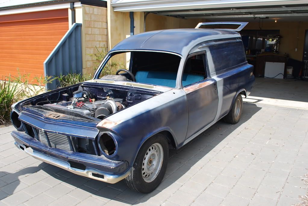

Hi hear are a couple of pics of my van. I have had it for about 12 years (11 of them in storage )and early last year i started the build . for somthing a bit different i stay with the inline six but istead of the old grey motor it now has a rb30 turbo out o a vl

thanks guys other than fitting a bigger trans tunnel and making some engine mounts it fits straight in. next is to plumb up the fuel system wire up the computer then its of to the tuners

thanks guys ill keep you all posted , bit of a list of whats been done so far
-frontend replaced with a hr CRS rack frontend
-24mm whiteline swaybar kit nolathane bushes throughout
-front drum brakes replaced with vn ss rotors and calipers + ss 1 inch master cyl and booster
-banjo replaced with shotened vl turbo 28 spline diff useing the vl disc and calipers
-CRS v8 chassis kit
-replaced all hard line and flexi brake lines
- carter black lift pump suppling a 3l swirl pot feeding the main bosch 044 pump
anyone got any questions dont hesatate to ask and ill do my best to answer
