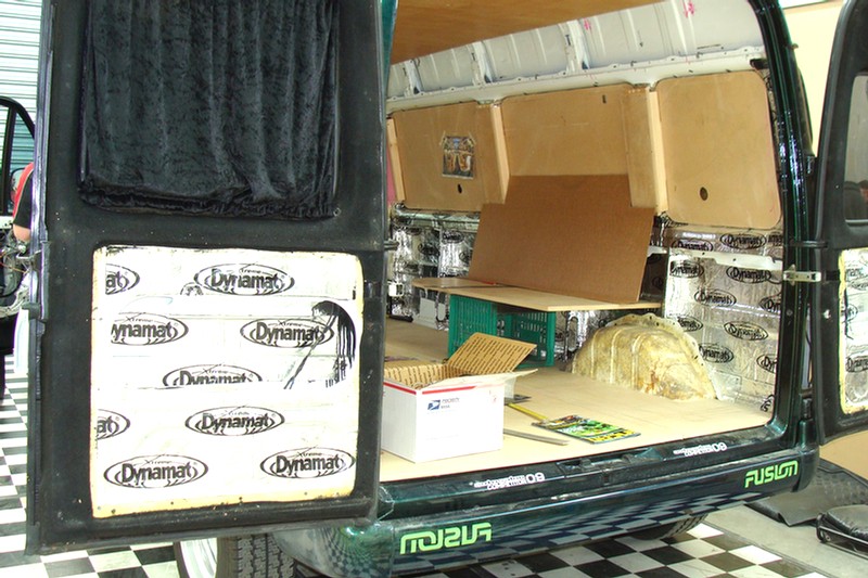

Post by Guest on 29/6/2010, 12:46 pm
Heres a good pic.
