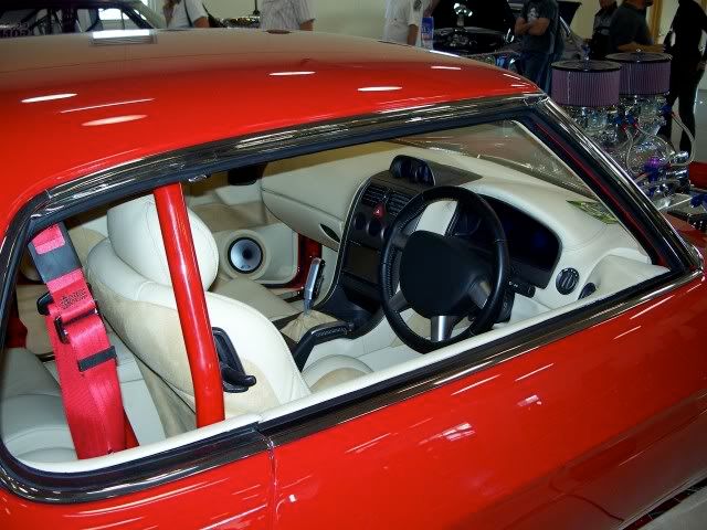

Post by soundman on 5/5/2010, 3:55 pm
not sure if it's the exact dash ur after but it certainly looks the goods.- HQ Coupe Bris Hotrod show a year or two back.
