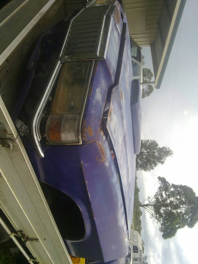

Post by mr sinbin on 5/4/2011, 3:47 am
just thought id through some pics up of the new front end i got for my van. picked up entire wb statesman walk off front end for the van last weekend. it needs a bit of work, but for the price i couldnt say no Very Happy
the front has 2 small sections of rust in the radiator support that need to be cut and new bits welded in, the top nose section needs some rust repairs in one corner, the passenger side headlight reflectors need rechroming, and its in major need of a sand and respray lol
the inner guards it cam with are perfect, just need a sand and respray and the bonnet with the scoop needs some patches done at the front as the guy i bought it off had bonnet pins lol. but these will probably only end up as spares.
its the outter guards that are the main issue, some real dodgey bogging Evil or Very Mad has been done in the past and its gonna take a big effort to sort them out, lucky i dont really need them tho. they will be left till last and put away as spares if i can fix them up.
so yea all in all it needs a bit of work, but will keep me busy and look a treat on the van when its all done Very Happy
anyways pics lol oh and no that isnt pitting on the chrome grill, just rain drops lol

Post by azwon on 5/4/2011, 8:22 am
i heard a rumor vb ,c ect commodore headlight reflectors are the same, haven't seen them close up but might lower the cost, everything stato is expensive
Age : 57
Re: My vans new heart!!!
Post by Mans Ruin on 6/4/2011, 3:57 am
jb camira headlight lenses are a perfect match, also the plastic adjusters inside an replace the stato ones if theyve gone brittle. can get complete brand new jb unit for about 50 bucks in bgo
